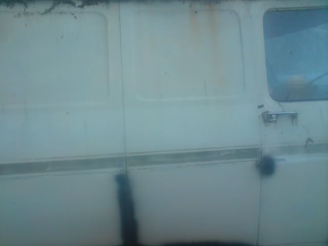

ok here is what i wanna do.. i want to get rid of the windows in the barn doors.. but i have 2 options.
i could just weld it flat.. may as well take a mould off it in case anyone wants a fibrglass barn doors.
or i could use the panel in the lwb instead on the back barn doors (same size)
and it would have a matching recess like the side of the van.. would probably do it in fibreglass.
who thinks what??

In my humble opinion I've always thought that the window recesses on the windowless panels actually break it up and make it look more interesting. Flat panels look very plain and boring although if you are going to paint a mural on it then the flat panels are a better way to go.
I'm assuming you're not going to finish up with a mural so I vote for the recess.

When I added a side door in my standard van I used the recess from the panel for the side door, had to shorten it a little.
Panels are just spot welded, and braces glued (if it has the brace) but I'd go with Warrens idea

ive done mine out of steel, cut a panel of steel 1/2" wider all round then the opening then formed it over a 1/2" bar to get the profile, flattened the edges before welding it in. i will post a pic of it when its been fillered and primed. quite easy really

ben ,  one thing to remember is that the window opening is smaller than the recess area on the side panels, i chose to leave mine as is to replicate a factory style door that hadnt had the windows fitted. if you intend to fill the window in you will need to cut a 1/2" off the window edge all the way round if you want it to be just like the side panels. ade .
