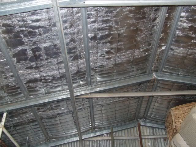

I made trusses by sitting a 20litre drum in the middle and putting C purlins onto the drum and a shelf on each side, then welding them together. I lifted the trusses up and tek screwed them to the top of the shelving ends.
I filled the ends of the sheds in by welding spare rails together and mounted the roller doors after repairing them.
I put the W strap on the roof as battens and rolled out the fencing mesh to support the insulation.

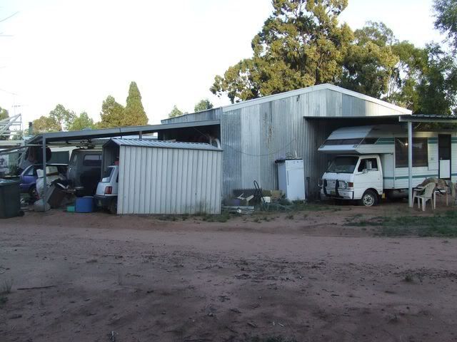

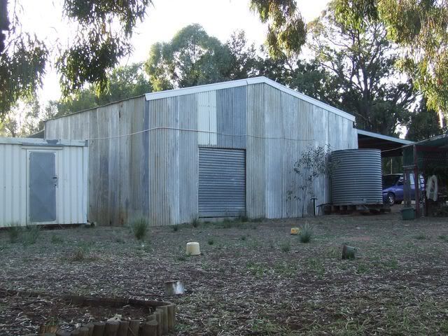

« Reply #6 on: October 01, 2008, 02:39:39 PM »
G'day
I have pictures:

« Reply #7 on: October 01, 2008, 05:31:31 PM »
looks like a cool shed Chris,
marty
Re: Custom garage ideas
« Reply #8 on: October 01, 2008, 06:02:01 PM »
Now thats a shed!!! No little backyard sewing room for me!! :o  Well done Chris...cheers..john. ;D

A couple of notes.
The shed is not big enough as it is FULL of stuff that needs to be sorted and ebayed or thrown out.
There is a 10m site shed that I use as an office.
There is a garden shed used as a carport for a little car. I assembled the garden shed and then welded a 25mm RHS frame around the bottom and one end. I then removed that end wall and the result is one relocatable carport.
