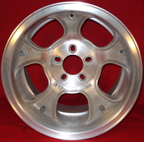

the funny thing is that although the difference between hq (4.75") and commodore (120mm) is less than 1mm, it will break studs,
they used to make mags with uni-lug
http://www.roadsters.com/E-T_III_500x492.jpg
these oval shaped holes could fit say ford (4.5") to drag (5") and anything in between (chev/hq 4.75")
