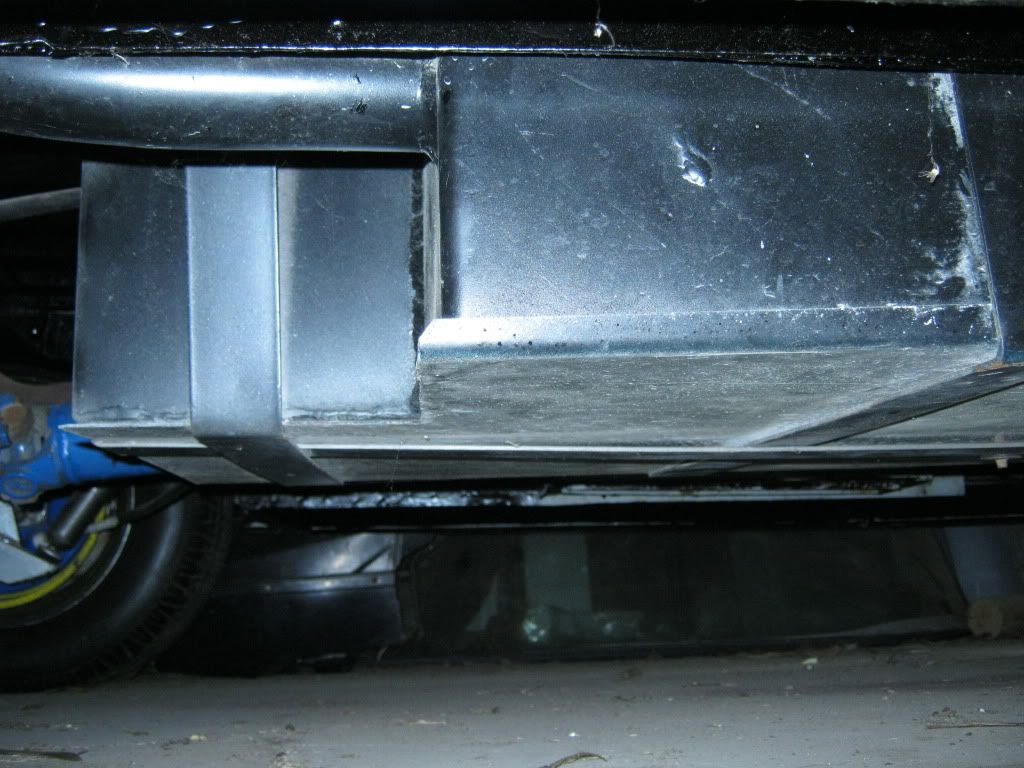

Guys, I have just custom fitted a vn 85 litre tank as a drop tank in the rear. Tight but I did get it to fit. Have to relocate both filler point in body and in tank itself.

Hey Johnno, at the moment i am still debating on how to go. But the easiest and probably the cheapest for me will be to get a pair of custom tanks done. What i have done is cut out my battery rack under the cargo door, and i am looking at maybe a 100lt & a 60lt with an external V8 fuel pump and a small pickup/surge tank, with a switch on the dash to switch from tank to tank. It sounds complicated but the advice from a few people is that it is a 100% reliable system.
Being that i am an amputee, in the landcruiser i have dual tanks, 90lt & 50lt and when i am half way through the reserve tank i know its time to look at filling up. In my case if i run out of fuel, thats it i am stranded till i can get help, unlike able bodied people i cant just jump out and walk to the nearest station, so this is a good backup for me. My beddy tank was to rusty to reuse, so i am going to mount the tanks on either side of the van, being they are custom, i can make them to fill up every last millimeter of room till i get the capacity i want.

My current van has a 100 litre custom made alloy tank on the driver's side, with new (larger) filler pipe.
