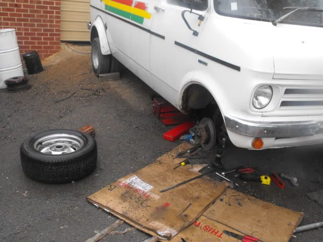

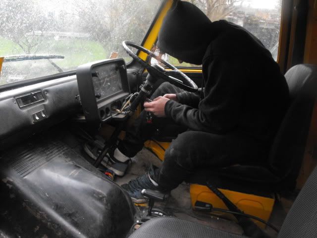

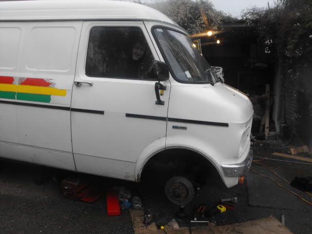

he folk me and jak "jakgore" are getting jak's van roadworthy at the moment. spent tue, wed and today onining,  his van and we are like 90% all done.
done lots of little things, second hand exahst, disc maching, new pads,
the list was a full page long. but weve got it down to only a couple of things left so where happy.
here are some pics!
oh great whether last couple of days! today is poo thou, rainy!!!

yes got all the wiring stuff sorted, indicator stalk was fine the indicator had the wrong globe in it a 2 prong when it should have been a singel.
rear indicator bad connection, light switch a bit dicky, brake lights switch adjusted wrong.,
we put the machined rotor on this afternoon, bleed the brakes, 2wice after one of the brake lines i flared didnt work properly, got another brake line and got him going about 6:30 this afternoon.
