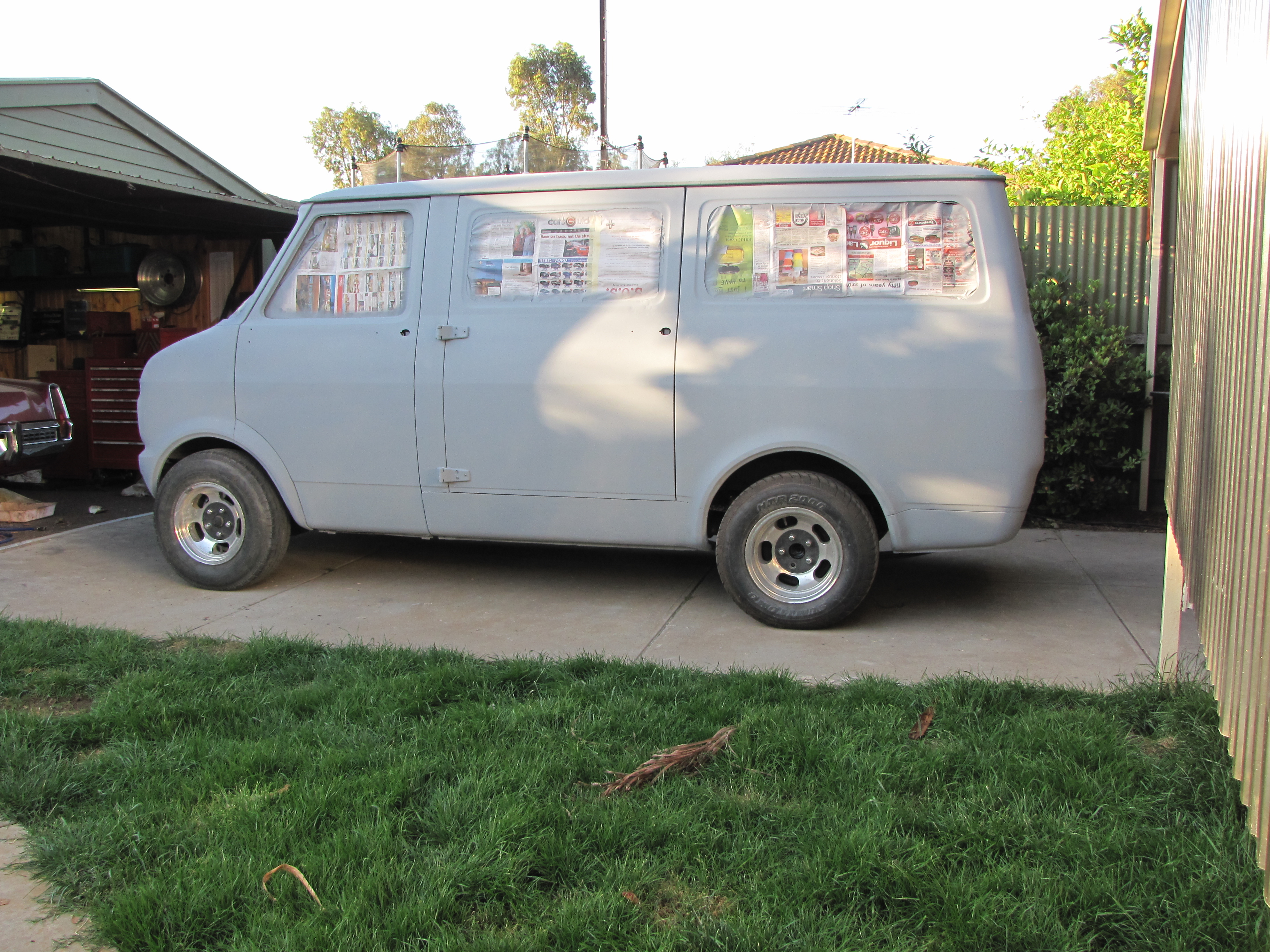

I think I achieved a decent hight, I would like it a bit lower, but the front cant really go any lower with out drop spindles or major mods.one coil cut from the front springs.Nissan patrol parabolic springs in the back (using original hangers and b I think I achieved a decent hight, I would like it a bit lower, but the front cant really go any lower with out drop spindles or major mods.
Nissan patrol parabolic springs in the back (using original hangers and body mounting points. a bit of messing around but it was worth it.
In the front she has a 20mm clearance between the wishbone and standard bump stop. front wheels are almost standing straight still, maybe about 1degree leaning in at the top.
it the rear there is about 80mm between diff housing and floor, about the same between axle tubes and bump stops.
I haven't driven it yet, but the only problem I can see at this point is the front bump stops (might have to shave a bit off)
